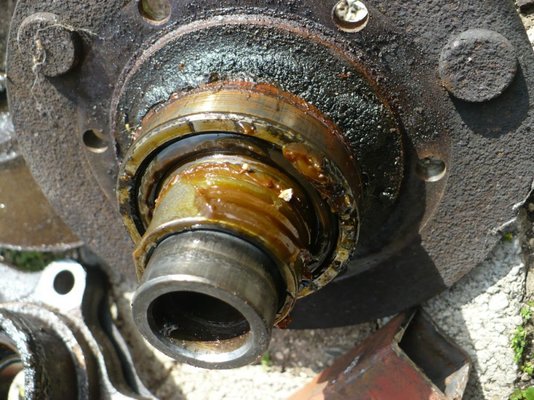

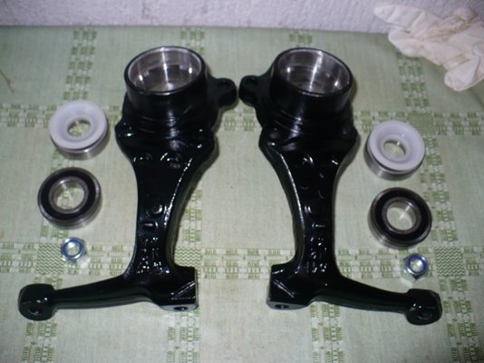

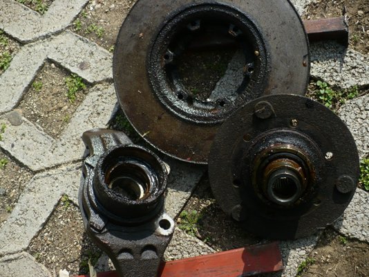

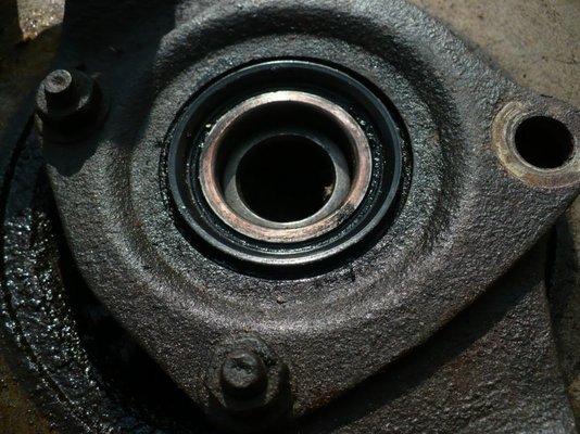

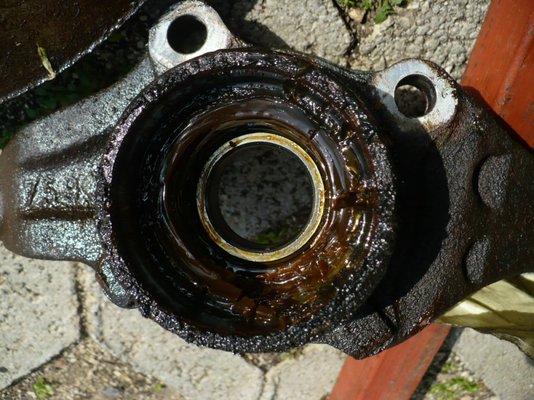

But here are pictures of mine front bearings when i was dismantle them.
Hope it will help to sort your problem, and put bearings in right place

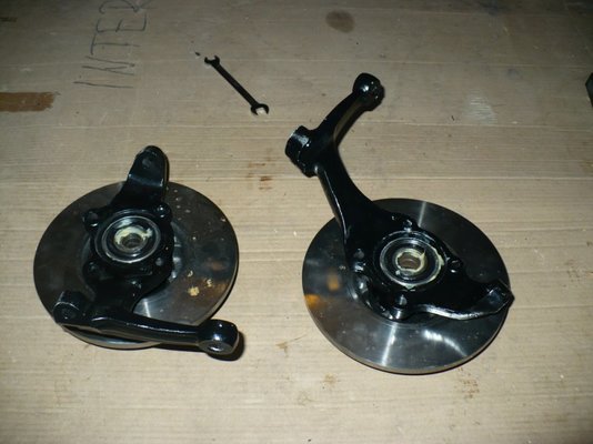

It is 1992 GTL
And new bearings in place
