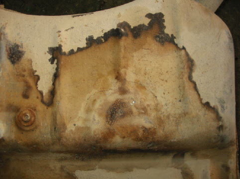

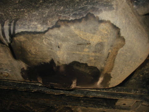

I have just taken some photos of the tanks
1 off the car and 1 I have tried to repair on the car
It is strange to note that both leaks are almost in the same place
The hole is tiny and has obviously rusted from the inside out

I am also surprised that you, having faced all usual and unusual chassis and body rust, haven't come across a rusty fuel tank!! They are very common even here in dry Greece! But as they always rust from the inside out, it may be related to petrol's corrosive action, and not wet weather.
The way to repair them is soldering, not welding. There are a few people here that repair radiators and also fuel tanks. As far as I know they first fill it with water, but don't try this at home, I have never repaired a tank myself! I had such a tank repaired five years ago and it is still leak-free.
However, I think that if it has reached the point of puncturing due to corrosion, the sheet metal may get very thin in a lot of places, and maybe will puncture at another place while trying to repair it.

We don't need them :D Don't know why, but the insides of my tanks have always been clean and shiny (or at least the insides of the ones I can see into). Maybe it takes a bit of heat to get the corrosion going.
My first port of call would be a motor factor or Renault to check on prices for new tanks. Welding is possible, though risky, so best to get someone else who isn't a friend to do it. I welded a diesel tank once by emptying it and filling it completely with water - that reduces the air space available for an explosion.
I'm not sure if they are still available from Renault, but it's worth a try. There are no pattern tanks available that I know of. I now feel very guilty as I threw a tank away just because it had some surface rust.

take the tank to a radiator repair shop, they can do it. i had mine done a couple of months ago 4 pinholes in 2 different places, i think it was about £50Try an independent, not national like Serck
