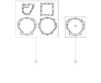

Im looking for the part number of the gasket between the bell housing and the main gearbox for my pickup...could probably make one but would like to get a proper job one if you can still get them..
The box number is HA0 163 with a fab number of 018318
many thanks
Andrew

Hello Andrew, problem is that my invoices just show the part number and then 'gasket' or no description at all. If you have the parts sysytem then won't that give you the correct part number? If the gearboxes look the same then maybe the only difference is the ratios.
Take a look at Part No: R77 01 454 326 as this could be the kit I bought for my GTL. The sad thing is that I threw the unused gaskets away a few weeks ago and they were still in the packet with the part number! All I bought it for was for the top gasket and the bell housing!
Hi Steve, cheers for that...ordered from my dealer, got to come from france but at £13.00 its not worth messing round with them is. Orderded 2 new diff seals while i was there...
