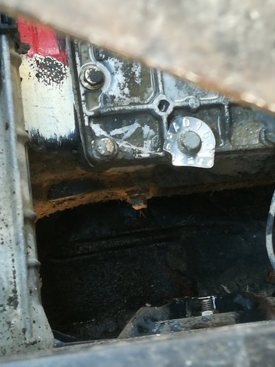

Hello everyone. I am aware there have been threads on this before, but I can't seem to find the gear box filler plug. Could someone send a picture or tell me it's exact whereabouts. Thanks I've attached a picture of what I think it is... IMG_20180827_184128.jpg

That's the one! There's a similar one underneath the box if you need to drain it.
It's best to use a special square spanner on these - they're depressingly easy to chew up.
For filling the box, I find it easiest to remove the undertray and use a container with a flexible spout. You can then squeeze the oil into the box - much better than approaching it from above, as you don't risk losing the top/spout of the container.
Hi Andy and Jjhad. Thanks for the advice! You are right about them being depressingly easy to chew up. I managed to destroy the engine oil plug a few months ago when changing the oil:ashamed:
I made my own tool to undo the filler plug the hole is 10x10mm
