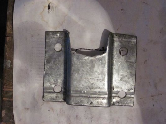

I did purchase new mount/support which i found missing.
Did not solve my problem, now i am missing the counterpart to be bolted to front crossover beam.
Any better photos anyone(i am gonna make the piece myself):eek:

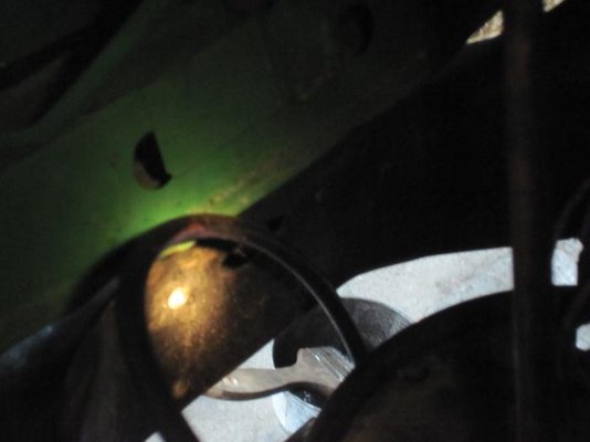

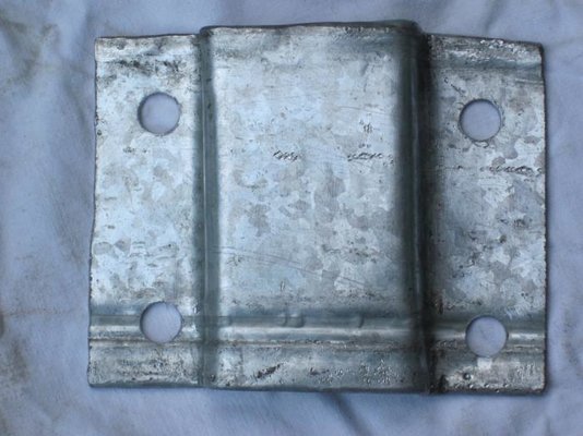

i'll enclose some phtos showing my tasks

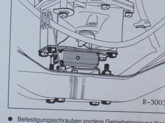

1)photo taken from service book

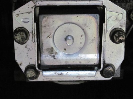

2)photo taken from the front beam

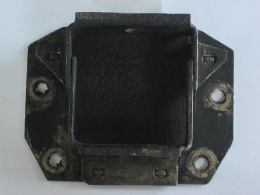

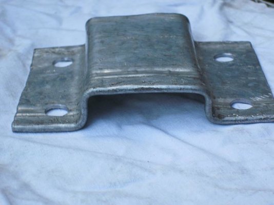

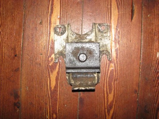

3-4)old and new supports

hole position on gear box front mount?
I did make the counterpart for support which purchased.
I estimated the gap needed (to fix the nut) but dont know shall the srew pin to be located in the centre or what, it makes a diffrence to gear box level
i'll enclose some photos showing my tasks

gearbox mount
now i made a space for the start-up crank hole, still missing information on what level to bore the dole-could someone take a photo so that gear box bottom level is seen compared to front cross beam underside(if your sump protection plate is iff)

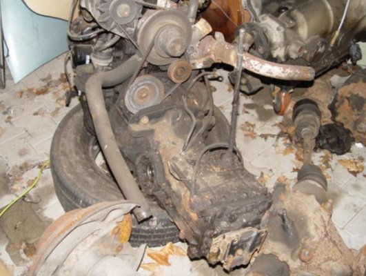

Hi
I am working on the car this afternoon, I'll try and take a photo.

Photo !
I would replicate the lip at the bottom as well - as I think this lip is designed to support the gearbox when the front mount snaps mine was any way !

Photo !
Tremendous !
Many thanks alewis
