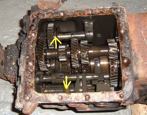

Here's one with the top cover off - I've not had a gearbox apart so can't give you photos of one in pieces.

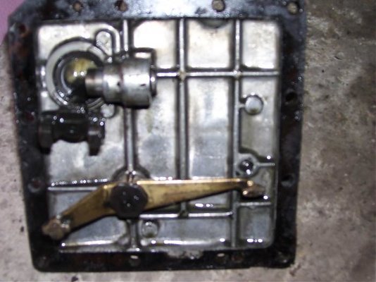

Thanks Man!i Hawe A Problem With My Gear Box.it Stucked In 4 Th Gear.when I Opened It Everything Looks Good.now I Dont Now Hove To Put Back The Top Of The Box.THAT GOLDEN LEVER YOU SEE ON THE PICTURE.HOW SHOULD IT STAY WHEN I PUT BACK THE TOP?

I think the selector mechanism should be aligned with the bits that are arrowed in this photo. By the way - please don't use all capitals when you post - it's as if you are shouting. :D

Kujo,could you tell me please if the U-brass part in my gear box is ok or not?
I mean to see on the other picture above,my one appears to be worn and torn...
It does not seem to be in a perfect U-shape.
reason
I could not move the gearstick anymore,and looked for the reason.
Fortunately I`ve got another gearbox,but it takes a couple of hours to replace the old one... :-(
I mean this part:
Wouldn't know, it indeed seems torn and worn. I will have a look at mine when I get back to it.

@knightscreek: Your gear switching mechanism is kompletly worn out. I guess, this happens when the gear change rod in the gearcover is not fixed korrekt.
When you look from the inner side at your gearcover you will find the gear change rod fixed with a big circlip. Behind this circlip is or should be a thick curved spring washer. Often this part is broken or missing. It's the most important thing to look after when gearboxes are changed.
