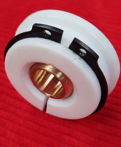

Just a thought- the gear lever bush looks not standard. Does it make any difference if you push or pull the gear lever a little?

@malcolm you are the men!! This bush is more tight than the original and without any explanation (today) part of some gear stayed engaged.
