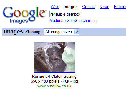

True enough - I've found a better picture in the book of Haynes. That's annoying - I'm not really in the mood for a gearbox swap this week. Still, no harm in having a look to see if it is something else. Tried google images for a better picture of gearbox internals but all I could find was that damned frog!
