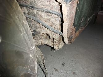

we are thinging of getting a renault 4l thats done 58345 miles but it's this rust hole going to look at it today socan i have some advice on it please ?I'l send some pitures of it

hey thanks for the reply we went to look at it today the doesn't look so bad on the other places he's got replacemt parts to put

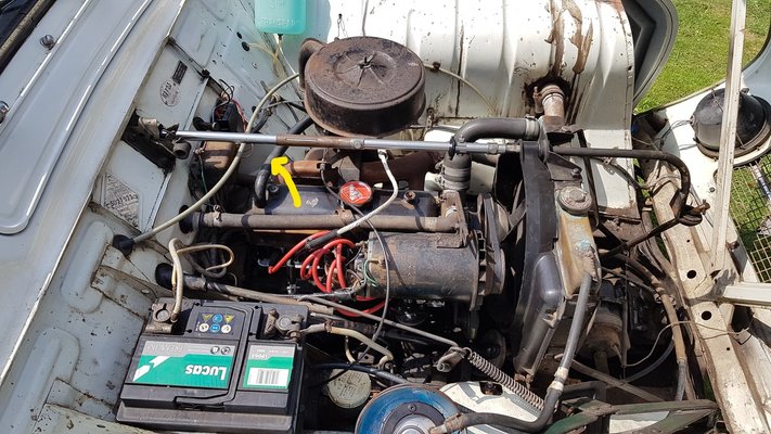

If there's no smoke from the exhaust, you could check to see if the pipe arrowed in this photo is blocked (I'm assuming your car has this pipe). It runs from the rocker cover to the carburettor.20190725_133903_LI.jpg
It'd be really helpful if you could post a few more photos of the engine bay.
