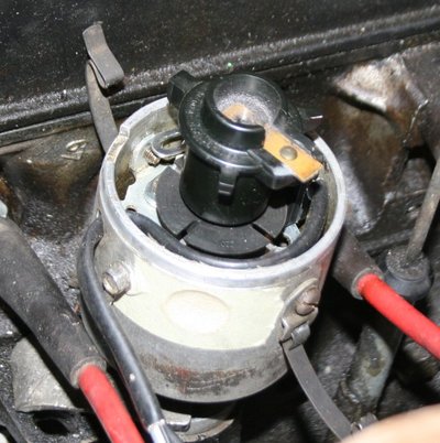

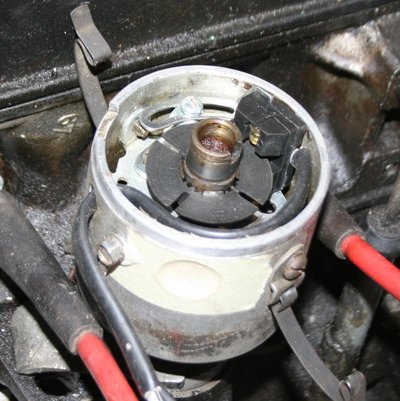

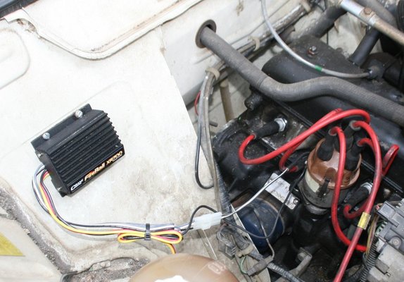

So, finally, this weekend I replaced the battery and discovered the points were shot to pieces (one of the arms had snapped). Having (#shame#) never got round to fitting the electronic ignition I bought in 2006, and being a little frightened of doing so, I just replaced the points and condenser. She fired up but coughed and stalled and no amount of adjustment would make her idle. So I bit the bullet and decided to fit the Crane XR700 electronic ignition.
Connecting the wiring and the amp is a doddle. Fitting the parts inside the distributor was more of a challenge because I had to grind away some bits of the points plate, but nothing too challenging for my limited engineering abilities.
When all was done I took a deep breath and turned the key: she fired up and ran. The petrol was pretty rank after two years but I filled her to the brim with fresh juice to try and mix some new with the old. Now, after a few hours of fiddling and just sitting in her enjoying the sound of the engine, she runs, she accelerates, she idles. That electronic ignition is a blessing. As always, I wish I had done it ages ago.
