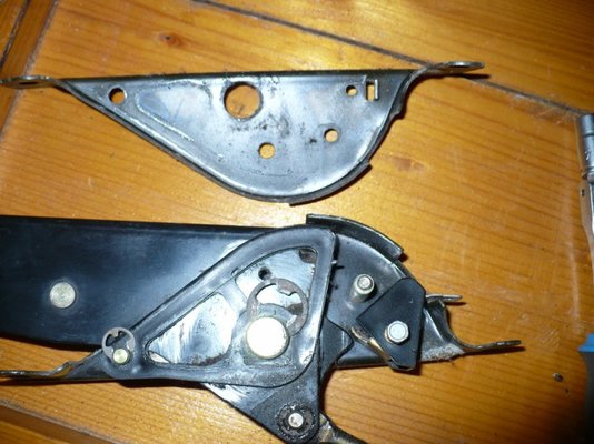

Here is handbrake with switch.
Switch is actually lever with spring. Only thing that came to my mind is that spring is broken but dough.
lever with base

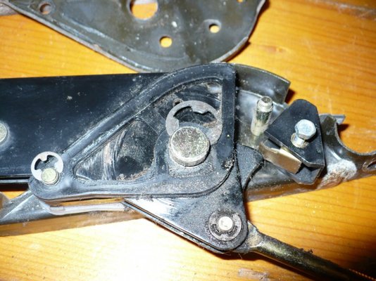

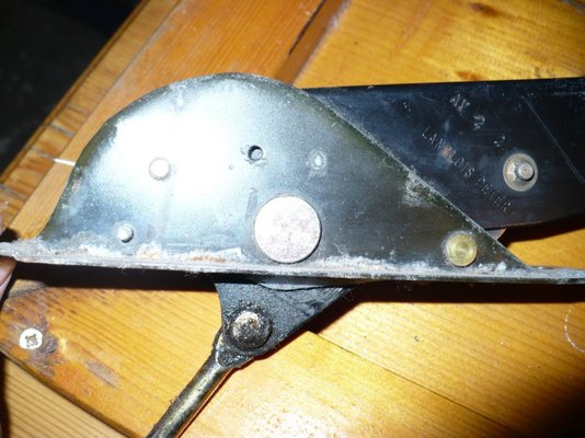

one side

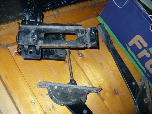

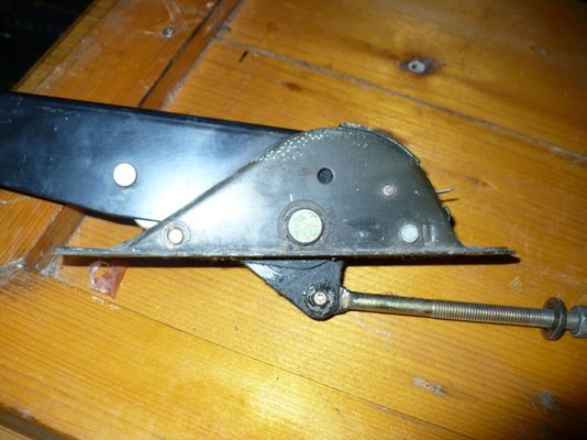

other side
Opened

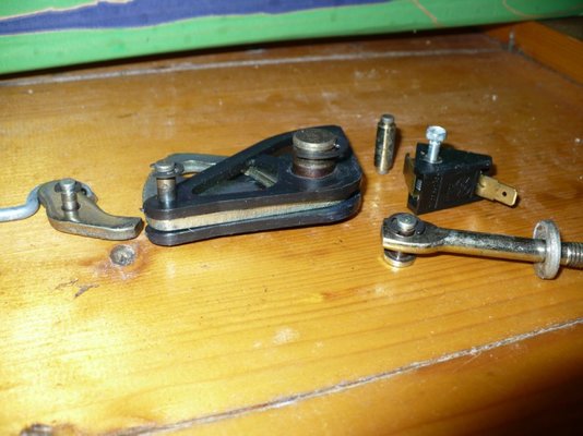

Closer look
Here you can see spring in switch
You do not need to dismantle handbrake to change it.
Only undo M6 bolt and switch will fall down.
Maybe it is wire that goes from switch to the dash. It goes on floor so you might brake it accidentally
Solved.... It was just the wire...I haven't disassembled anything, just touched the wire and that fixed the problem..in the end she only wanted some attention..
