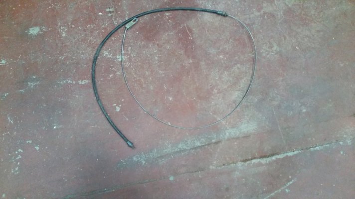

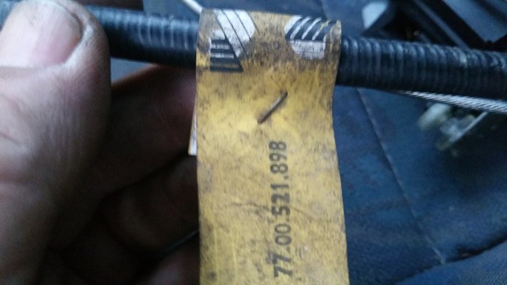

Found 2 of these today check numbers against the parts manual tomcat has got available as pdf file
Both 1 metre first section 1.4 inner bit after that aprox 20150911_182328.jpg20150911_140652.jpg
Will send if you want
thanks for that Paul; i think during a stroll round the ancestral home - that i might have sorted this out. Now all i have to do is figure out how to make the bonnet catch fulfill it's function - not arf!
