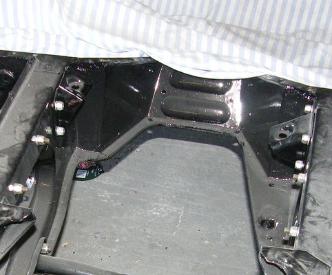

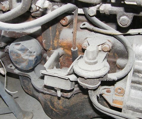

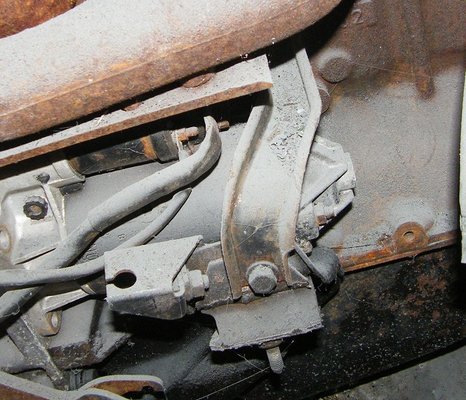

Do you have Easter on a different weekend in Norway? Photos are a Gordini (apart from the first two - that's the lovely Yvette), but I'm using the GTL mountings for the engine.

Your last pic (5) showing identical engine-mount w. rubberblock to that I have on this R5engine (LHS) should there also be a 'support-strut' to keep engine from jerking??
Have been on this Fantastic forum ALL day to look for previous info,
Have now concluded that the Frame-mounted engine-mounts for the R1225 are indeed different(angle) from the ones on Roffen..
On your pic no.4 they look to be near horisontal where the bolt would go through-Right? Roffens framemounted brackets are angled inward at around 42degrees..

The RHS engine mount (looking forward from the driver seat) doesn't have a brace. That's only the other side where the starter motor gets in the way of any sensible reinforcements.
If it wasn't so urgent I might have been able to help. I have the parts but they will be difficult to retrieve for a couple of weeks until I move my bodyshell. Until then there is no access.
Check the mounts on the engine - I've a feeling I changed one from the R5 type. I think the RHS one, but I can't remember why.
looks like we are on the same page here Malcolm! -Only LHS should have a brace -as does this R5 engine I have.
Will have a real close look at the mounts but they look exactly as yours inc.the RHS-one maybe you had to change it because it had cracked-up and died .
I guess the production-parts were welded on to the frame and as
spare-parts they will come as bolt-on, like yours.
