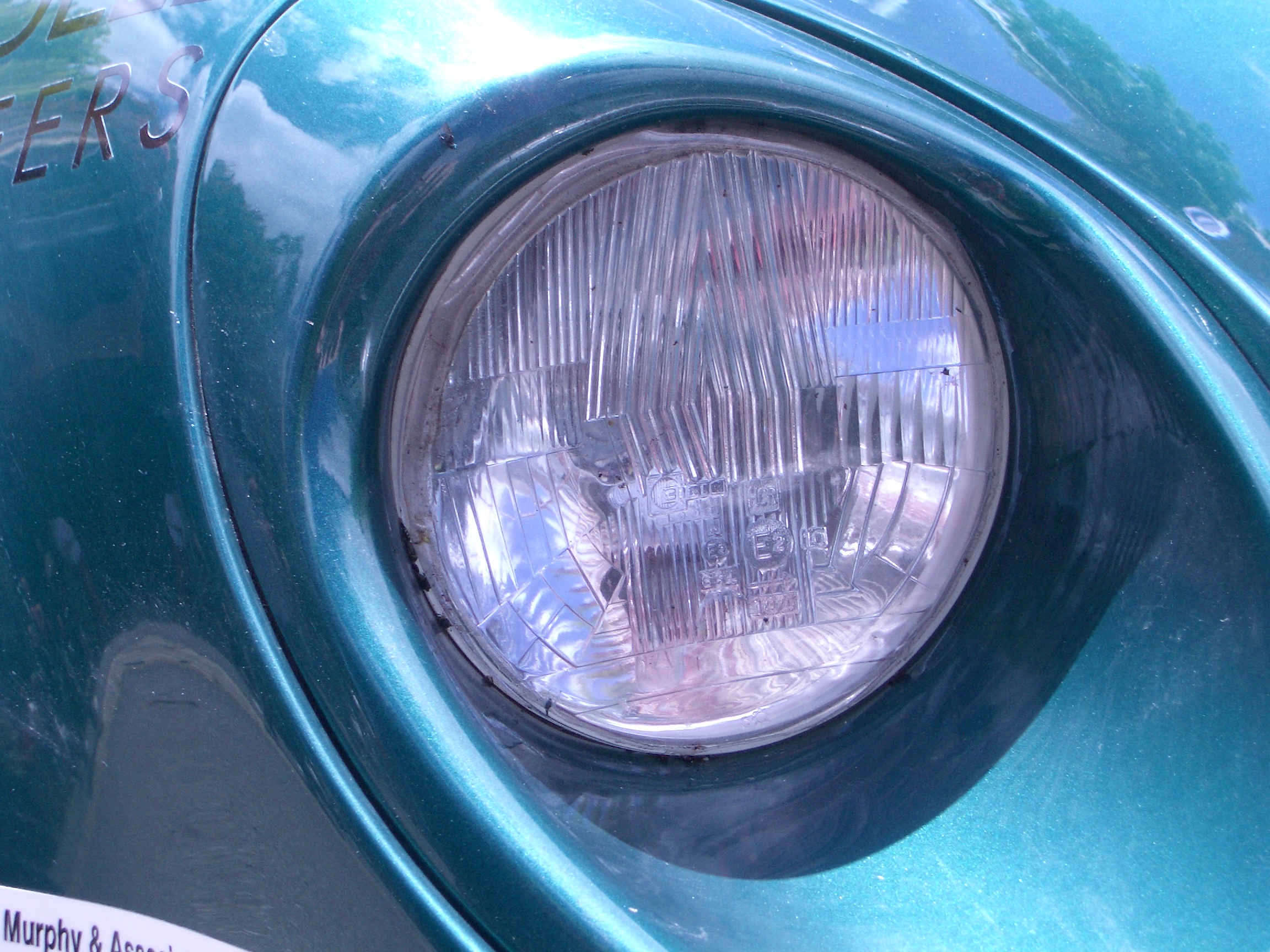

It also probably depends on whether the glass itself is RH or LH drive too. The R4 glass doesn't have any bias on the lens, however some lenses you see do have "RH drive" moulded into the lens.
More on R4 headlights- The early one (up to late GTL) has no lens bias. The late one looks similar, has a concave lens the overall shape like the early one but has a new glass pattern and does have lens bias. The Lotus Elise S1 uses the same as the R4 late headlamp but has an integral sidelamp like the early light UK and Australian versions. Also made for H4 bulb not the P45 type bulb. I-ve seen them being advertised for 32 quid in the UK.

Lotus Elise S1 headlight (from a flying visit to the Classic Adelaide rally). Looks like a late R4 GTL one to me (but with parking lights).
