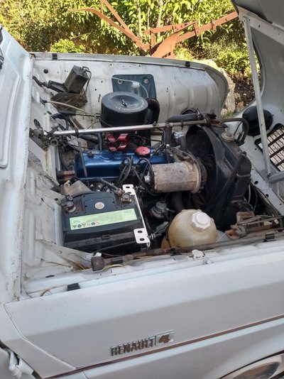

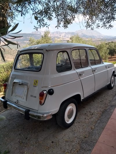

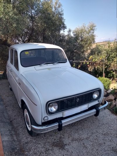

Nice looking car. Is that an original arrangement of fittings, or have you added things and details that you liked?
It was quite a mess when I bought it so I've been trying to tidy the car up aswell as things like new steering rack good service etc . I'm in the process of changing the door window frames from metal to plastic from a car I can take bits off .
