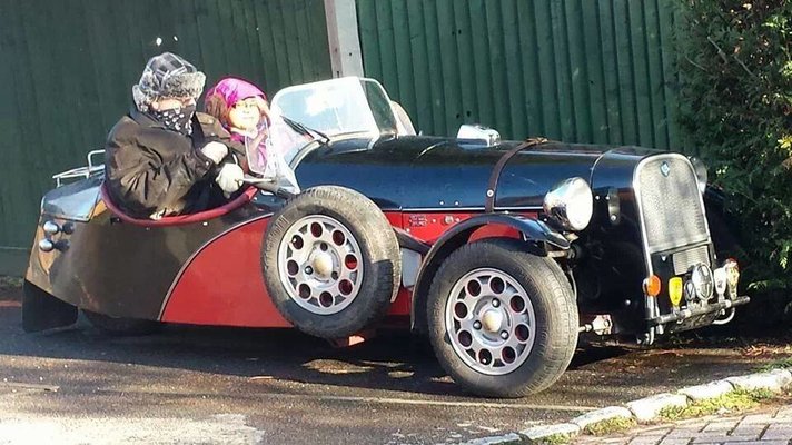

It's a thing called a DRK. It's a Morgan-esque 3 wheeler special - one wheel at the back, based on an R4. It was originally built on a 1978 model with drum brakes on the front. It's since been upgraded to an 1108 cc engine that's had head and cam work, and been lightened and balanced down below and had new liners, big ends and mains fitted. It goes well and sounds great.

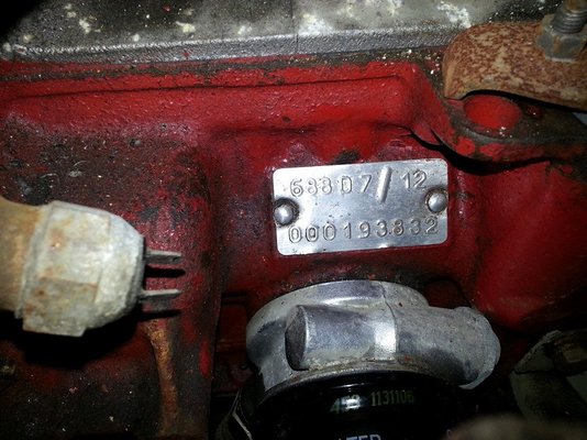

I'd like to find out when the engine in it was built by Renault. I need some oil filters for it. The engine number is 688D7/12, and underneath that it says 000193832. Can anyone tell me what year this is from? I did an oil change anyway, but I'm not convinced the filter is correct. It fits and doesn't leak, the thread was the same as the on that came off (an old TJ FB3000) but I'd like to be sure as it's tuned and I like to use it. Might be confused by the fact it has an oil cooler fitted too.

Looks like a great forum with some interesting tech advice! Pic of my beast attached, as is a link to my Facebook album for that interested in more than one pic..
all the best
Hello and Welcome! Your car looks great. I've always used 15W40 in our 1108cc GTL. There were different types of oil filter fitted (see http://quatrelle.wikia.com/wiki/Oil_change) but from my own experience of getting the wrong thread type, you'll know if it's not right. As yours isn't leaking, I suspect that you're OK.
Your engine identification plate doesn't quite conform to what I would have expected for a GTL, which is of the form:
688 X 7 / 00
Y 000000
where in this example '688' is the engine type, 'X' is the engine type approval letter, '7' is the Renault identity, '00' is the engine suffix, 'Y' is the factory code and 000000 is the engine number (see http://quatrelle.wikia.com/wiki/Engine).
But I'm sure someone on here can help with the year.

Here's a pic of the identification plate on the engine. Does that help decipher what year it might be?idp.jpg
Hi, I've not seen that part between the block and filter before. Sorry I can't help with identifying the year, but someone else might know.
That part is just the take-off for the front-mounted oil cooler.

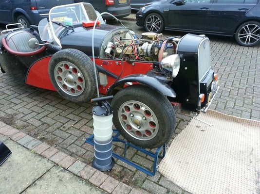

Great looking car, I have a set of those wheels sitting waiting to be restored.
As for changing the brakes I wouldn't bother I have drums on my heavier full bodied 4l, they work brilliantly and the disc set up isn't a huge improvement and has a very heavy pedal!
As an aside, how do you find the oil extractor? Does it work well?
