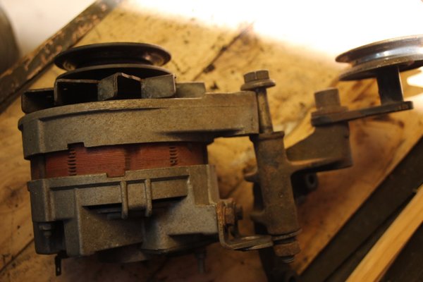

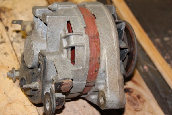

But what really confuses me, if I chose to get the 'new' style Renault R4 alternator with a regulator built in (which there are many), the mounting position is different??
The one I have has two mounting arms on the bottom, and one on top. The new ones only have a single mounting point, which will clearly not fit using the current hardware? I think this is the one the store had that I saw- Valeo 433401, and the pictures below are what I have, definitely won't work. (Additionally, they would be able to order/get a Mahle MG400, Guttels 89771, or a Delco-Remy DRA1791 -but I presume they are all the same style as the Valeo)

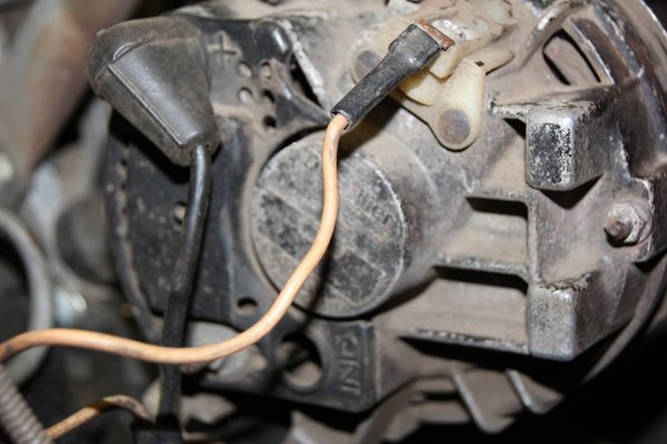

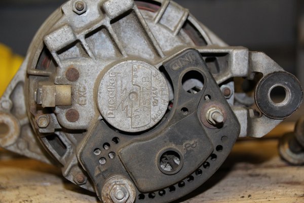

This is what I have-
benchalt1-jpg.19551
Back of alternator-
benchalt2-jpg.19552
Hardware/Alternator on bench-
benchalt3-jpg.19553
Inside the engine-
mountedalt-jpg.19555
Hardware inside engine-
mountedalt3-jpg.19557

The Ducellier number in your picture is 7597B rather than 7579B.
Have a look at eBay# 391853532497 - it's a remanufactured Ducellier under the Lucas name (LRA203); the Ducellier number is the same as yours. 45.00 GBP + 27.84 GBP postage to the U.S.A.

My mistake, they are both 7597B/E. I will probably consider that ebay listing, but will still need to find one more...
I ended up getting a remanufactured Lucas LRA253 on ebay, it is advertised to fit an R1221, but is exactly the same and significantly cheaper for some reason.

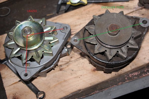

I thought I'd advise anyone else considering an LRA253 as a replacement alternator. I'm not sure if it's just the one I received, but the front mounting position is different.
This may have been a mistake during re-manufacturing? The back plate of the LRA253 is stamped 'Ducellier 7597B', so I don't know if this was done intentionally, or if the wrong front plate was put on. See the pictures below.
I tried mounting as is, and everything lines up, but the tension bar does not reach, I guess I'll have a little extra work of putting the old front plate onto it.
