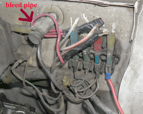

Have you bled the system of air with the heater control on hot ?
On my 1977 R4TL there is a small hose on the bulkhead/ firewall (next to the fuse box) which is the highest point in the cooling system, and this is where you bleed the air out of the system.
Open this bleed hose and run the engine on a fast idle with the radiator cap off and as the water comes out of the bleed hose keep topping the radiator up until you see no air coming from the bleed hose ...only a steady run of water. Then close the bleed hose off and you should have no air in the system.
If after this you still have heating problems remove the thermostat and bleed the system again. If this solves the problem replace with a new thermostat.

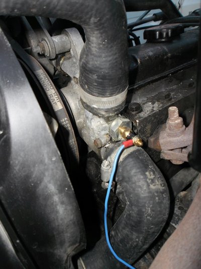

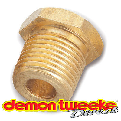

390820043569 this is ebay UK but I am sure you can get one in the USA ....I also had to get an adapter as the original sender in my R4 was a large thread and needed to be reduced to accept a normal sender unit I got this from demon tweeks on ebay UK 301102375441
You can see the adapter with the new sender inside in the photo and the new wire I ran from the sender to the gauge..

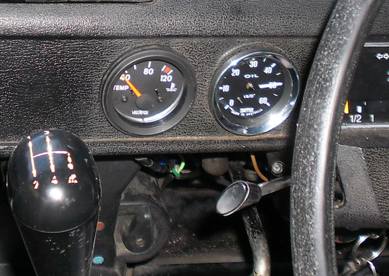

Real easy job to fit but worth being able to see the temp the car runs at ! she gets to 80C and stays there all day and we have temps in the 40'sC here in the summer and I have to climb to the Troodos mountains in these temps so I needed to see what she was running at as my fan is fixed and pre- electric fan type.
