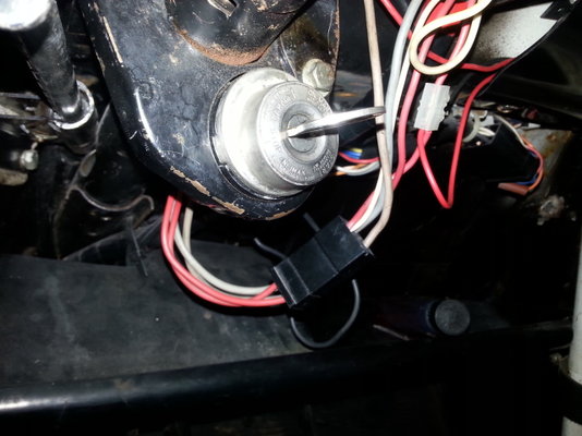

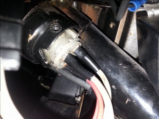

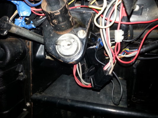

20150115_200609.jpg 20150115_200609.jpg 20150115_200517.jpg 20150115_200429.jpg Right then gave it a good go, but stuck wont turn at all removed locking bolt but wouldnt budge even with screwdriver in hole. Will prob have to hot wire it. Have included pics of wiring and barrel in situ.
Three wires into the back of the switch( 2 red into one terminal) one not labled, one says bat + and the other translates to coil.all into 4 cell connector (black). Any help would be ace.cheers
You need 3 out 4 wires connected together for ignition to be on leave the grey wire separate touch grey onto 3 already joined release when start engine
Disconnect 3 joined wires to stop engine
Looking at pictures yours most be pre 81 rhd car
There is separate hole to push in release mechanism this will be at bottom of metal surround
If you are still stuck ring me Friday morning and will tell you more
Number on profile page and have got spare lock if all else fails
