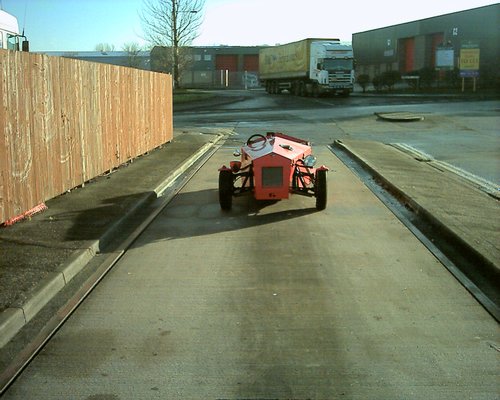

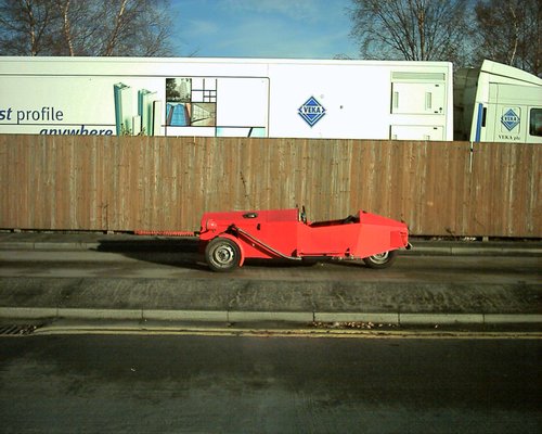

I have spent the last few years building a 3 wheeler special based on an MOT failed, rust ridden R4 GTL. The trike is due for its single vehicle approval test at 08:00 on Monday morning (22nd May). Hopefully, I've managed to attach two pictures.

The trike has a semi-spaceframe chassis, and a fabricated rear suspension arm using an Avo adjustable coil over shockabsorber. I carefully cut the stub axle out of the renault trailing arm and pressed it into a tube which is welded into the new trailing arm. It seemed a lot simpler than trying to locate a transverse torsion bar across the rear of the chassis, plus because the rear weight is greatly reduced I really needed a to be able to play with ride height / spring rate etc.
However, my Dad has a 2 CV based trike he built about 6 years ago that does use a reversed rear suspension arm to put the rear wheel on the centreline of the chassis.
I started designing the car in about 1999, but work, redundancy and housemoves have kept getting in the way of completion.
I do have some pictures of the chassis, suspension etc. I can email if your interested
