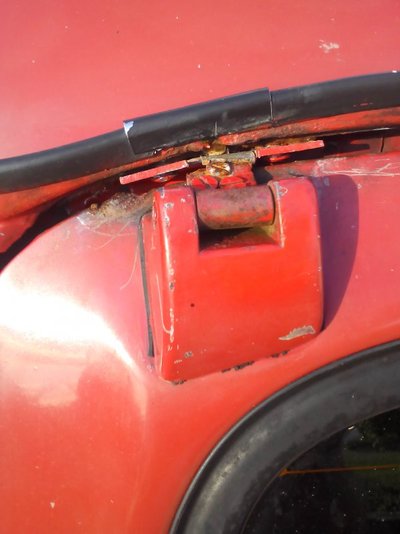

I'm new to this forum, I have recently bought a Renault 4gtl clan, 1993 model. No doubt this subject has been covered before but as I am new to 4l's I would appreciate any advice offered. The year door/hatch hinges have rusted and broken, does anyone know who sells the fixing points that weld onto the roof, or any enthusiasts that make good after market parts, I am having great difficulty sourcing these as Renault no longer show an interest, thanks in advance.

Normally it is just the roll pin which just rusts you should be able to drill it out and put a 7mm pin or bolt in. If the welded part is broken off the roof is that rusted away?
It is common for the roll pin to seize and the metal part attached to the roof break as a result. The metal part can be welded back on fairly easily and is fine when the pins are greased.
Yes its the welded part that is snapped, it has been badly repaired in the past, I will have to find someone local to do that, thanks all.

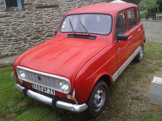

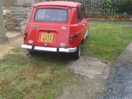

Woop woop, we like pictures :-D
Looks excellent externally...
Its solid underneath too, just one major area is back tail hinge and seals.
