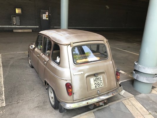

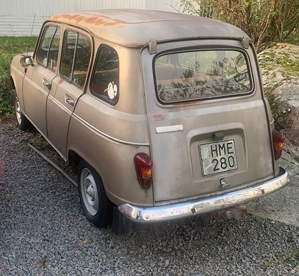

the green metallic looks like browngreyred on the outside and very nice green inside were sun and wind haven’t reached. I bought this and the better 1972 from a old man who should use it as a spare car. I thought it was too good for spares so I welded root in chassis and fixed all mechanics and got it MOT I think you say. Drive it a year or two before the paperwork under the cylinders said goodbye. Now it’s sitting waiting for engine to be fixed.

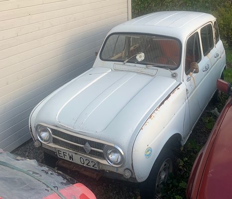

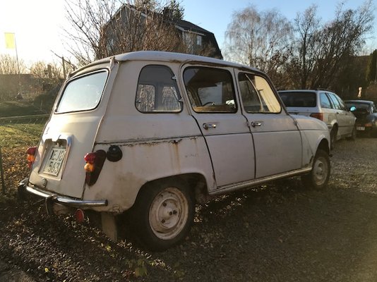

This 1972 white with red interior was the car that the old guy was aiming to fix. Timing chain and sprockes have given up. So engine need renovation and some welding to the chassis is needed. I think I split body and chassis on this one when I have time for it. All cars need some attention with the welding machine but have withstand Swedish winters with salted roads well.

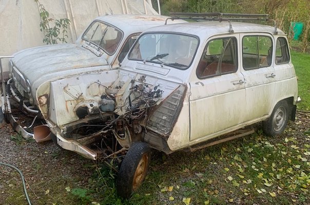

The other 1972 white/red I bought together with the 1962 from a 90 year old architect who have had them since new. This one he hit tree stump and ruined front chassis. The frame for the lover right wishbone is so bent that the driveshaft pops out. I think it can be fixed with some portopower but for now it’s spare car.

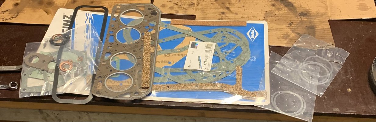

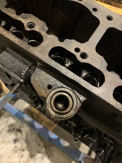

Bought gasket set brand Viktor Reins.

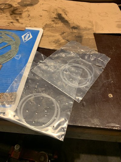

Everything looks good except cylinder shim/gaskets are not paper typ but in some plastic material see picture.
Anyone have experience from this type of cylinder shim/gasket.
