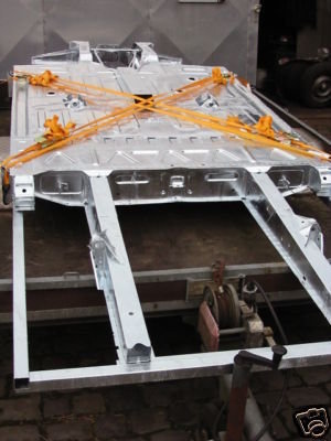

Do you know anybody who did hot galvanizing on R4 chassis?
I have found one picture galvanized chassis in Deutschland. But I do not know anything about what was done, and how it was done.

I can understand about the chassis being liable to twist during the galvanising process, but it looks like someone has tried to reinforce the chassis that you have pictured, to prevent just this happening.
