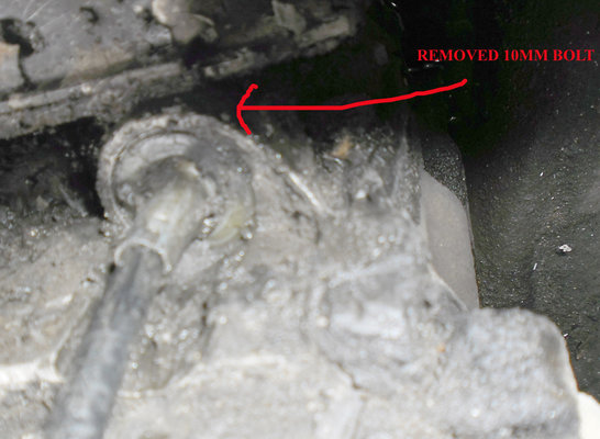

Can someone PLEASE tell me how the speedometer cable is removed from the gearbox ?
The only book I have at present is Autopress 1961-70 and it has no mention of it in the handbook!
I have removed a 10mm bolt beside the cable entering the gearbox , thinking this was holding it in but it still will not move out ?
The top is white nylon and has no clip on the top so what holds it in ??
Any help ........anyone ?................
The bolt holds it in. When the bolts is removed only the only thing holding it is years of dirt and gunge.
Give it a good dose of WD40 or similar and be patient with sideways jiggling.

THANKS Geoff, got the bu**er off and new one installed........I truly believe cars have souls.....mine ( le petite cochon ) has decided to firmly resist being brought back to life ....preferring to sit motionless in the sun all day !
P.S. ......and isn't that little 10mm bolt a joy to get back in :mad:
Ah, yes. The secret to that, which I remember too late to help you, is that it doesn't need to come all the way out. Just loosened enough to free the cable. Makes it a lot easier for the reassembly stage.
Of course, when the cable is stuck in like yours was it's hard to know when the bolt is 'loose enough'
