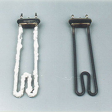

If it is scale/limescale/tartar (all words from google translator), white thing that is left on pipes after water is dried out, that is blocking your jet try to put it in vinegar for some time (24 hours at least).
Look picture
On left heater is scale all around. right heater is clean
Vinegar will eat up scale. Not whole thing (maybe it will) but good enough to push it out with strong water jet
If it is some stone or some else trash not sure will it work
