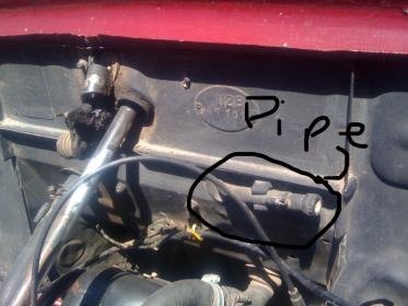

Ndelilio Nnko Enthusiast Messages 182 Location Arusha. Tanzania. EA Oct 16, 2013 #1 what are function of this pipe? it may cause heat in r4 if not open sometimes! or it may cause radiator to be boiled?? 2013-10-16 10.23.03.jpg 18.7 KB · Views: 117
R r4-gen Enthusiast Messages 14 Oct 16, 2013 #2 That's the air bleed valve, to let any trapped air out of the cooling system
P peterlaws New Member Messages 1 Oct 17, 2013 #3 Bleeding coolant system If you have the plastic expansion bottle lift it higher than the heater matrix (heater radiator) and open/bleed this pipe.
Ndelilio Nnko Enthusiast Messages 182 Location Arusha. Tanzania. EA Oct 20, 2013 #4 Thanks alot I appreciate your help! Now l know how to maintaine my R4.
