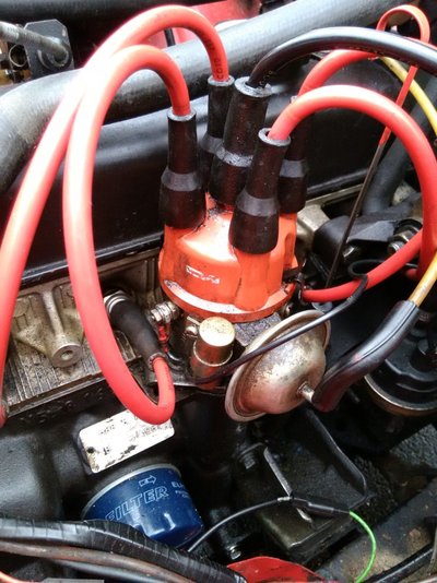

Hi all
I need help in identifying a reference to the points in the photo, I know the distributor is a Ducellier, the car is a 1992 4gtl clan, I wish to change the points to an electronic ignition, I contacted powerspark but they've been no help at all sadly.
If any savvy mechanics or enthusiasts can help with my dilemma I will be grateful.
Any links and serial numbers will help too.
There should be some numbers stamped on the outside of the distributor body. They might be useful.
Thanks I will look later, and will this determine which system is compatible?
Hi there, if your distributor has R224 D61 stamped on the side can I recommend an EP 141 electronic ignition kit from Aldon Automotive. Piece of cake to fit, and very reliable and effective. It retails for around £150. Regards Brian.
......and which I wrote about at length only a few weeks ago. All details are within the article.
Is that different to the accuspark or powerspark kits they're around £50, but getting one of thier tech guys to commit to which is compatible is difficult.
Hi PPP, I can't really compare the Aldon product with the two types you mention as I'm not familiar with them, but the Aldon one simply has a small module that fits inside the distributor along with a magnetic sleeve that fits on the spindle. Two wires connect the module to the coil. This set up completely does away with the points and condenser.
  • Like
Reactions: PPP
The accuspark and power spark use the same system @Cornish4
All based on the Hall effect.
@PPP you can just buy one and stick it in. They fit any ducellier dizzy.
Thanks, if that's a universal fit, sound good to me, will I have to provide a serial number when ordering? And where are they available seeing I don't have an eBay account, I'm old fashioned regarding internet purchasing.
