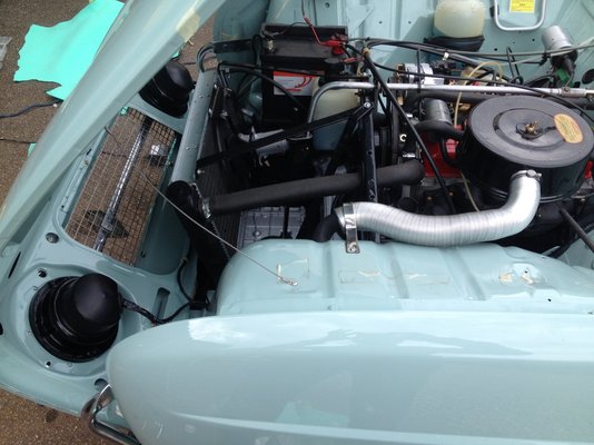

Grenuj Enthusiast Messages 206 Location Ulcinj Apr 15, 2020 #3 Some old ignition coil need to stand only vertically because they contain oil..If not, they overheat and go bad.. i watched someone mount them horizontally. liht.jpg 213.4 KB · Views: 3
