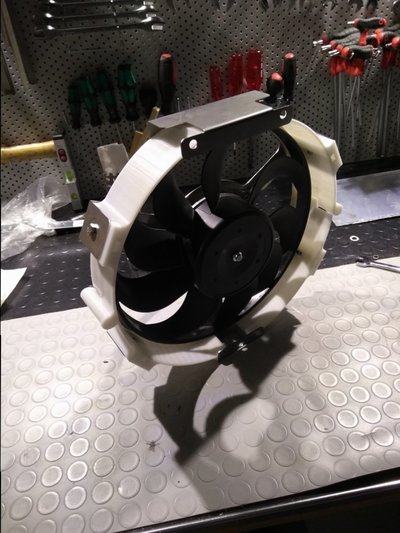

As my R4 suffered a very hot summer this year I tried to figure out how to improve the radiator fan efficency.
I know that someone install two original fan with an offset as the space isn't much.
I wanted instead to try to install a two speed high power fan from a modern car as shown:
Today hopefully I'm going to connect it to a double radiator switch (for high and low speed) and try how it works.
Finger crossed!

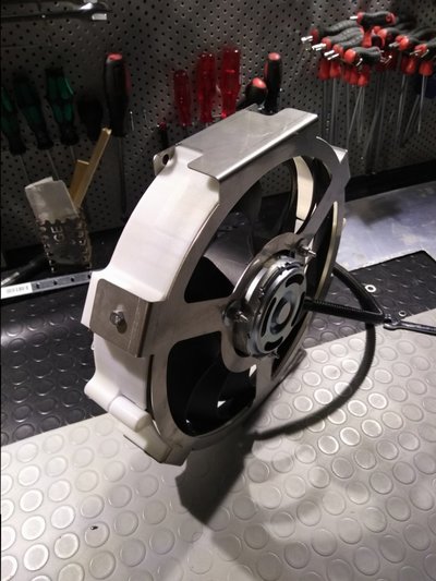

The connections are going to be made today, but I assembled the finished 3d printed conveyor. And tomorrow I'm going to the Italian club meeting and I'll properly test it!
