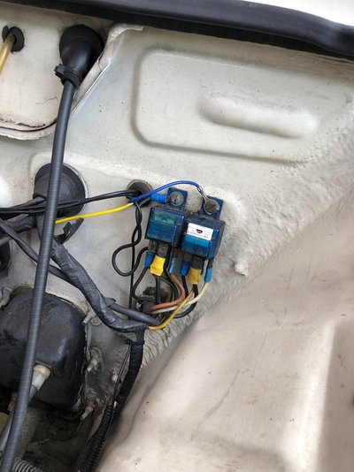

Hi Malcolm,
Thank you for the information!
Is this the parts you're talking about? (Sorry, I only know a little things..)

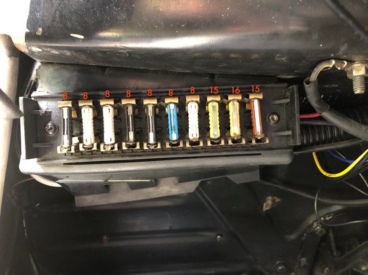

Could the smell be related to fuses? Is there a wrong sized fuse being used somewhere?
Hi Edwin!
Thank you for your help!
I don't even know all the fuses are correct size.. I took a photo and checked numbers.
Do you see any wrong size fuses?
The relays you have are not standard for the R4. Someone has messed around. I guess order replacements from the part numbers on them, but it'll probably be an earthing problem as mentioned above.
By the way, a great looking car, and great to see someone driving an R4 in America. Where did you get it? More photos please!
Going back to the fuses, I can't find a picture of the fuse board in haynes, but I have one in my Renault handbook for Ronnie, which is an '85 845cc car. It has the same 10 fuse slots, so may be the same. One of you will know and correct me.
If there is an electrical burning smell, and then something does not work, the fuse board appears to me to be a first port of call. Easy, and cheap. Go to the expensive or difficult after you have checked this. There is a diagram of the fuse board for my 1985 845cc car below in the attachment, showing the fuses, and their circuits. Your car is an 1100 cc, with probably more electrical kit, so the fuse board may be different. But is appears that because bits for R4's are difficult to obtain in the US , improvisation has taken place. Someone here on the forum with more experience than me will know the correct details of what you need to have. And I would get a full set of fuses.
Ok, I will order the correct one soon!
I am also guessing the wiring is wrong too. This car was restored (Cheap low quality restoration.. ) long time ago..
Thank you for the diagram! This helps me a lot! I checked all the fuses today and numbers are good, but probably wiring behind the fuse board is wrong....

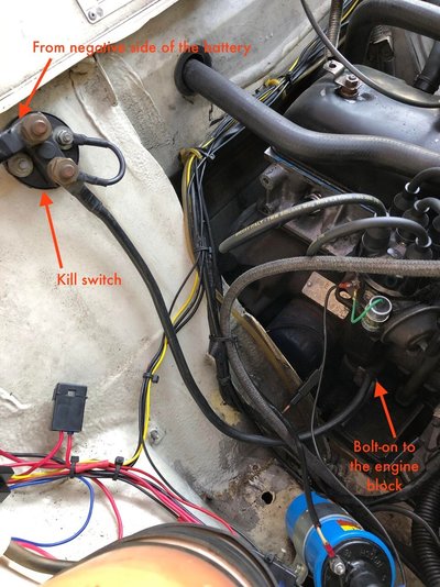

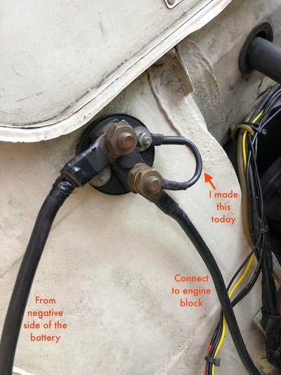

ALL WORKING NOW!!
I took a good look of the engine room today and I found out the cable from negative side of the battery is only connected to the engine block.
I made a short wire to connect the negative wire to the body and it's all working now!
Please let me know if this is not good way / not safe, Or If you know better way to wiring.

I'm glad you have sorted it out. It might be even better if you connect the lead from the negative side of the battery directly to the engine block, then run a wire from there to the car body. The reason fore this is that the thicker lead need to be bolted to the engine block, to give a good earth the starter motor. The thinner wire could be attached to the same bolt at one end, the other end being bolted onto the car's frame (or body) The burning smell you noticed was the car's electrical system earthing out through other wires, as the body wasn't earthed until you fitted the lead!
Good luck.....
Good luck.....
Thank you for the tech! I will definitely change the wiring!
