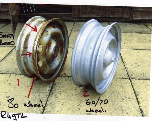

The later wheels like the 4 GTL has a safety bead,it is raised about 3mm a bit back from the outer rim edge to stop the tyre slipping off the rim when cornering our when bumpy,this is a tubules rim,
The old wheel has no safety bead so the tyre can slip off, this type of wheel
must have a tube fitted.
I have always been told that you can fit tubes in a tubules tyre but not when the tyre has a sidewall less than 75.

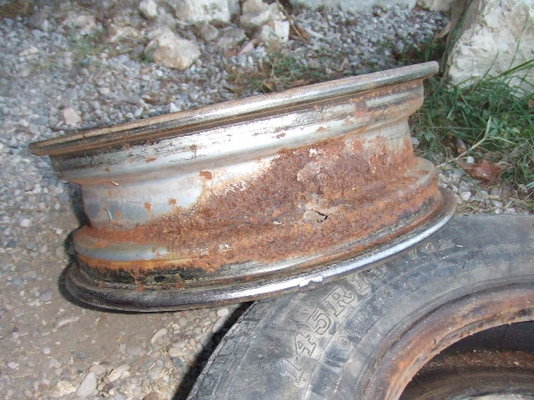

In the past year I've refitted 5 tyres.The 3 that had inner tubes had very bad rust damage inside. The valves don't seat too well in the rim hole and water can easily get in and cause rusting.
I cleaned up the corrosion on the lip of the rim and refitted tubeless tyres and haven't had a problem since.
It's the corrosion on the lip that causes slow leaks as the tyres can't seal correctly, and that's why tubes are fitted. It's the lazy way!
My wheel rims are like those in mojobaby's picture, only a bit less rusty.
