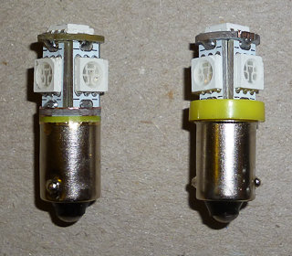

Indicator repeaters
Borderline. Again these amber bulbs are not particularly bright, but probably good enough for repeaters. Getting them to fit in the Renault sockets required grinding off the big yellow collar, as shown.

Indicator repeaters
