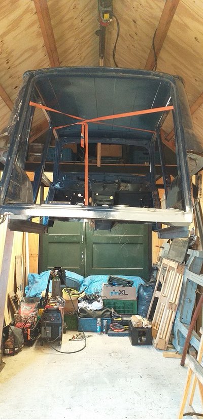

I think you've got to be creative with materials like an electric winch, hoist joke and the +2000 years old technology of pulleys.
Furthermore a sturdy construction like a massive ridge beam in a shed that can hold the weight.
electric winches that lift 800/1000 kg cost approx. 150 euro's
I myself hoist the body to the ridge of my shed during restoration.
