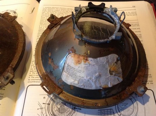

Hello everybody ,
After Bernadette "R4 gtl" failed this year it's mot because of the incorrect aim of the beam so I looked in lenses and headlights i have and I found these, are they left and right hand drive in the same time? Is is that it?

no they are lhd only, the lamps that can be used for rhd has a plastic bit that angles the bulb differently. I think I have the metal brackets somewhere which do have the adjusters if your interested, you would have to fit them to your existing headlamps. as regards the mot results you are going to have to buy some ball joints, a gaiter and fix the leaking exhaust [exhaust paste on the joints ?] the rear lens ? is it faded or is it wired incorrectly ?

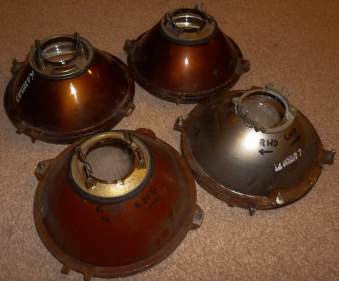

Here is a different one !
Thanks for replies guys, I couldn't believe what I was reading on the sticker. It's quite ingenious, here is another variant :

Headlamp aim could be because they are LHD headlamps. A link was posted to sort that.
The light illustrated at the top is a LHD/RHD adaptable type, but it is missing the little plastic "snib" that realigns the bulb.
What plastic snib you're talking about, "Benchseat"? They have a plastic bit that you can move from side to side which leaves a dip for the bulb to bulb to sit in it, that's all.

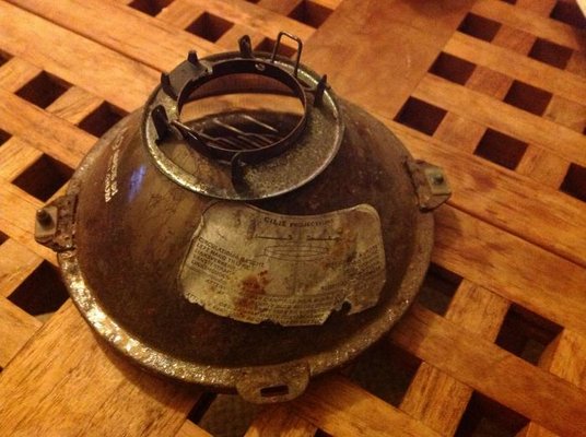

Your headlights are the original Cibie's and these were meant for both LHD and RHD cars. The lens was suitable for both. I first came across these in 1979 as Cibie also made a 7" version for the Minis produced in Belgium. You can't get new adjustable Cibie's now but I believe you can get the LHD ones new and just cut a small slot about 3/16" to position the bulb to make it suitable for RHD cars. I had to do this when I worked on European made Minis without the adjuster fitted.
None of my headlamps have any plastic bit...
The two in front are ones I've modified as Malcolm's method, the two at the back are a spare pair I bought at Thenay that I've not modified yet.
It's time to change over to the spares because the original pair are rusting on the inside.
The problem is, one of the spare ones is missing its little metal tab from around the rim. I'll have to take one off the old lights, but I'm not sure how best to attach it because the originals were spot welded, presumably before the glass was fitted.
