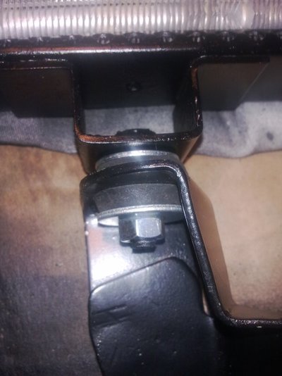

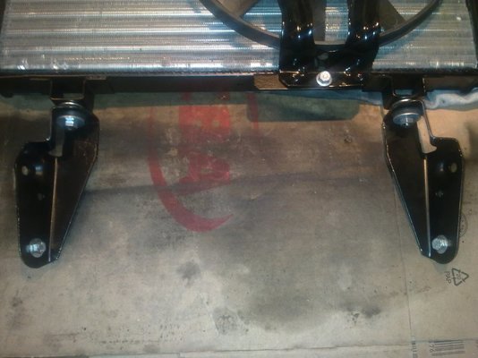

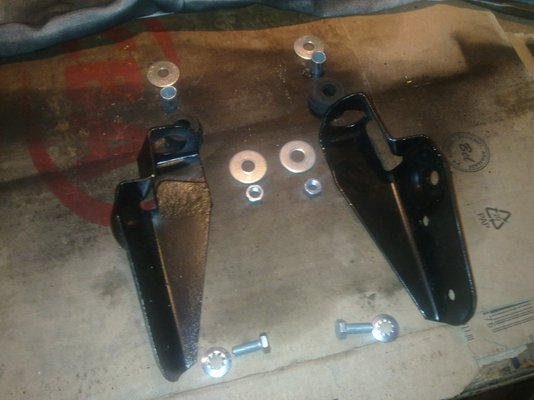

Some pictures of that lower mounting points.....
To me it is much easier to understand thing if i see them
If only they were all that shiny when you come to undo them very common to shear off
