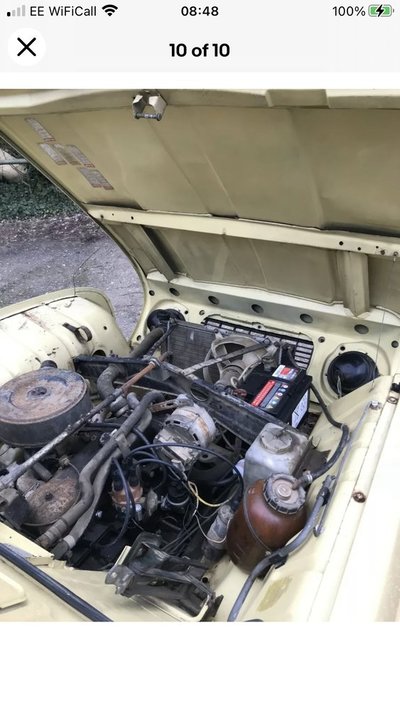

Could anyone tell me where the air cleaner pipe runs to and if anyone has a spare one or if I can buy a new one?
Mine is missing!
Many thanks Mike….

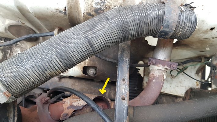

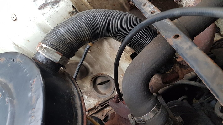

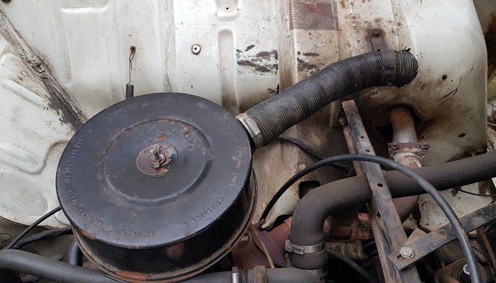

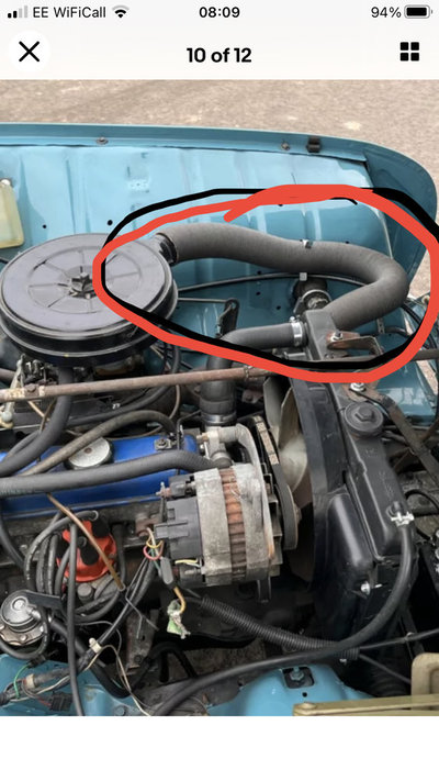

Thanks Andy,
I presume the pipe just “hover’s” above the exhaust in winter setting then hangs over the wing for cooler air in summer?
I would imagine it’s quite a stiff pipe?
Mike
I think the pipe has (internal?) diameter of 45mm.
The genuine Renault pipe is quite stiff I think.
It is a very stiff heat resistant pipe (possibly asbestos lined) goes onto a clamp around the exhaust pipe
If desparate I possibly have both bits Gerald
