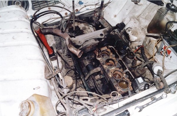

We've had an emotional few days since the last post. We set off from Almaty in Kazakhstan in search of a mechanic to retorque the head, but we left a bit late and all the garages had closed. So we changed the oil ourselves and pushed on determined to find someone the next day. Unfortunately the only mechanic we found didnt want to know - I dont think he fully understood what we wanted, but was basically gesturing that he couldnt do anything for us if we had head issues. So we pressed on again...
Then it all went a bit wrong! Lots of white smoke was coming out and when we stopped the car the whole engine siezed!! I couldnt believe it, we were really convinced that was the end of the road. We got towed back to another mechanic (at 100 km/h, faster than we could drive it!) and they dragged the car around a car park in gear until the wheels started moving again.
We've got to a proper town now on the back of a transporter and have another new gasket winging its way to us from Holland via DHL. We've has a very good mechanic look at it now and he doesnt seem to think we have done any serious damage to anything else, so fingers crossed we could be on the road again in a few days. We're definately getting it dont properly this time though! Head skimmed etc. They seem very professional this time.
So we had a few days thinking the car had finally died. That was tough! but its looking fairly positive now. Our only problem now is running out of time for visa and to catch flights from UB!
