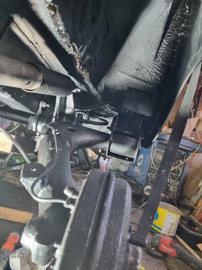

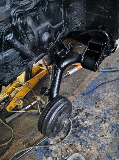

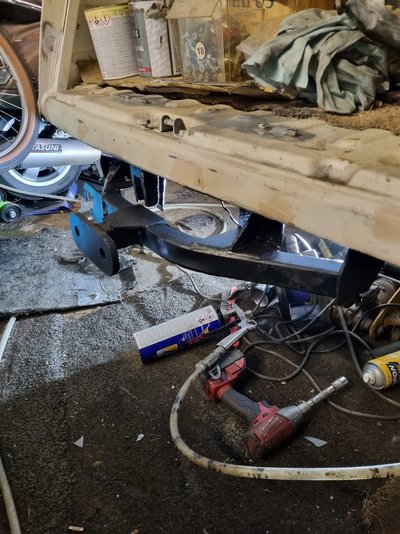

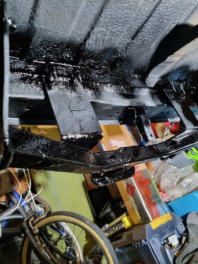

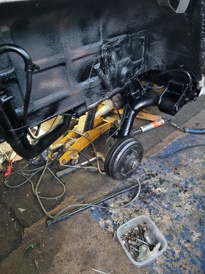

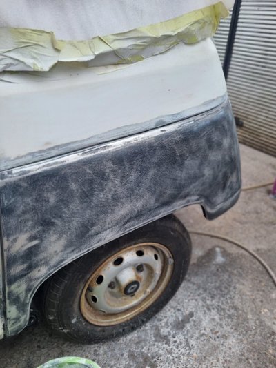

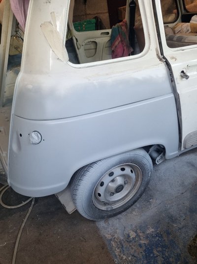

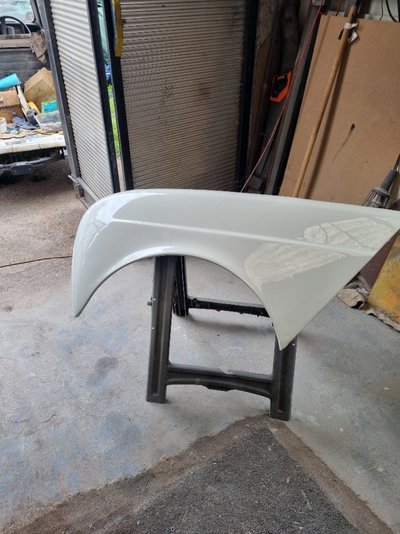

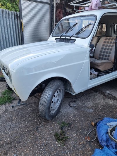

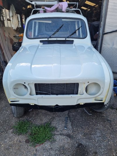

Haven't posted any photos before but I'm getting close to finishing the back end apart from prep/paint. Managed to get some body schutz on the weekend. I've lost my strip down photos so couldn't remember the correct way the fuel pipe was mounted over the rear suspension (think it was on a plate which Ive lost) so I've just used a P clip to the body. I've since added a small ally plate over it to stop any crud or stones etc damaging it. Bit the bullet and bought a new Towbar, although have no idea what I plan to be towing but least I'll have something to walk into for the next few months. I must have spent 3 hours fettling & messing with the one rear wing which I finally got fitted (not shown) back to the front end next. I've had the bonnet chemically dipped/stripped there's quite a few dents that need straightening out. The front wings also need work and I need to blend the front A pillar sections in that I've replaced.
