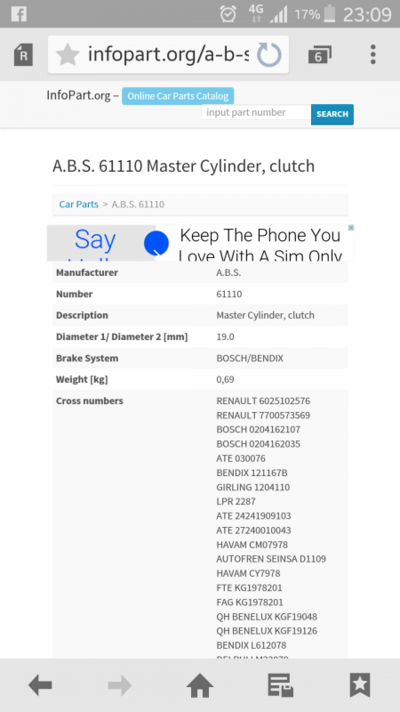

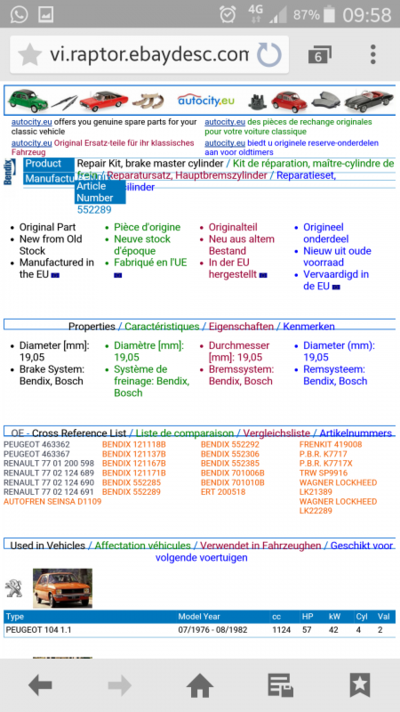

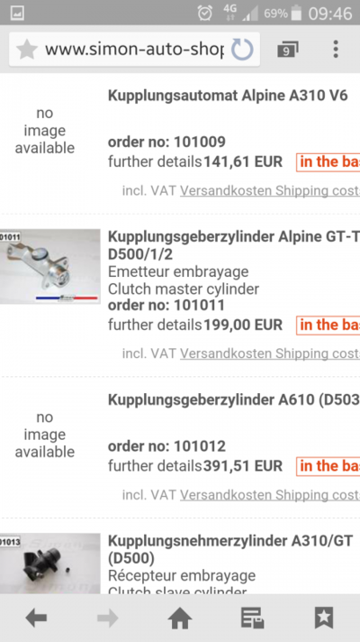

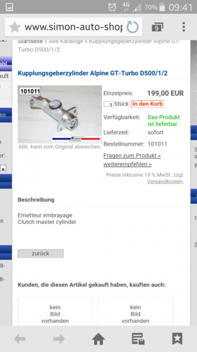

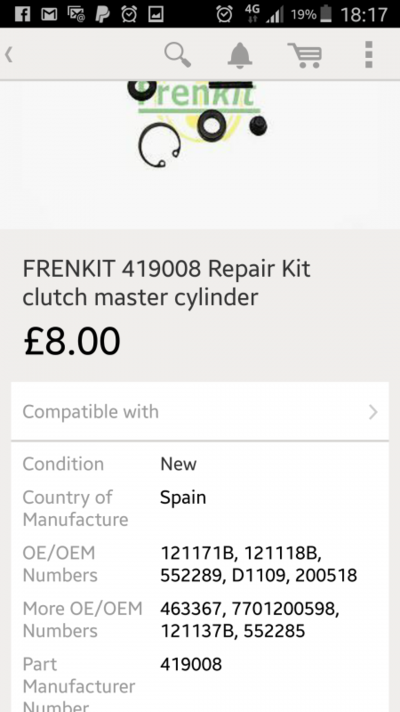

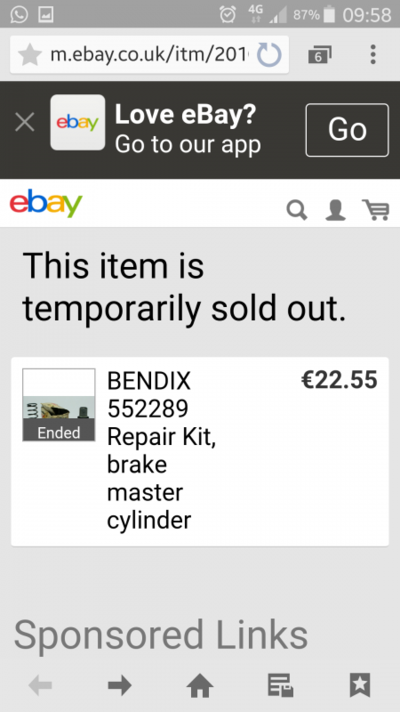

Screenshot_2015-08-11-18-17-13.png Screenshot_2015-08-11-18-42-06.png Screenshot_2015-08-11-09-41-58.png Screenshot_2015-08-11-09-46-53.png I can help you with this as had same thing with alpine A610
Simon auto in Germany sell kit but no stock when I tried
Tried to fit gta master cylinder which I got from my friend and threads different
Ended up removing piston and internals
Bought a honing tool and rebuilt it my self
Had to buy 2 legged honing tool as 3 leg ebay one said 19 mm but 22 is as small as it would go
That sorted one out 4 weeks back

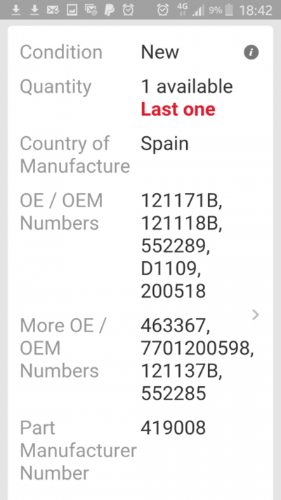

Next was finding bits to reassemble the gta one as it was needed for a v6 renault 8 !!!!
Contacted a seller on ebay who found link to his last one in stock in lithiunia took 3 weeks but was only 8 gbp in postage
Took R8 one off to find slightly different design but once stripped seals are identical

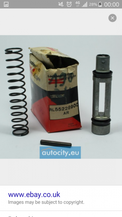

Problem with this type is taking circlip out does not release piston and there is a roll pin
This kit is used on peugeot 304 and simca brake and clutch master cylinders
I honed and resealed the earier type as the output threads were different on gta
I am fitting it to car tomorrow I have got loads of screenshots and Web links to cross reference part numbers it is possible to get a complete kit with piston and spring too
Do you use whatsapp or facebook messenger as inserting links and pics on here is hard work as i've got to find and insert one at a time Screenshot_2015-09-23-09-58-23.pngScreenshot_2015-09-23-09-58-45.png Screenshot_2015-09-23-23-09-06.png
This what you need if your cylinder has roll pin
The gta and 610 I stripped had no pin just circlip
