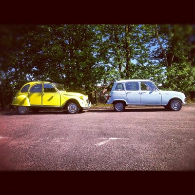

And to celebrate, I attach a picture of my two wonderful French classics (taken last weekend when the sun was shining.)
