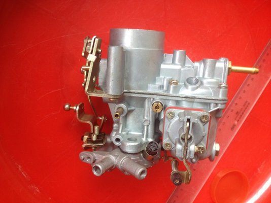

I notice someone on Ebay is selling a batch of new old stock (I assume) Solex 28 IBS carbs.
They look interesting/tempting to me because they have an accelerator pump and might give the R4 a ltittle bit more get-up-an-go than the usual zenith 28 IF.
Anyone have any thoughts on: experience with these, good or bad? How does parts availability compare to the zenith? What markets were they used in? Worth a try?

Oh! Then what is the thing on the side of the float chamber? I thought it was an accel pump...
but maybe this isn't a 28 IBS at all, althouigh that is what they say it is. Or is it a later version fitted on something like an Extra?

It is definitely not an IBS, it looks like a chinese knock-off of the 32 EISA. Throttle diameter is definitely larger than 28mm.
Better stay away from this one...reminds me of a Taiwanese SU copy I had the chance to admire recently...
