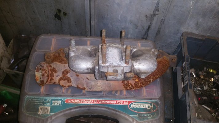

I have got a suitable manifold I could sell you
Very rare now from a renault 5 ts 1976 to 1980
This will bolt on to your head and the exhaust is correct outlet position to match your existing system
However I've never tried this with 1108 engine only 1300 and 1400
The carb you have may not be jetted correctly or may be fine

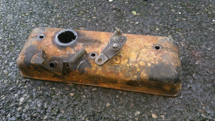

Paul, how much would you want for the manifold and, if it's not a silly question, I don't suppose you have a rocker cover too? Tim
Derek at renospeed said I needed to find the rocker cover off of a Renault 5 of that age as well as the set up is different as I asked about this route.

Paul,
Not sure if I replied correctly as the forum is new to me but would be interested in that manifold. Please let me know how much you want for it. many thanks, Tim
I think it should be not really difficult to weld something on a r4 rocket cover and make it similar to a r5 one...
Or just bolt an L shaped metal bracket on the inner wing and let the gas cable work by the other side of the carb...
This is what I've got there is supposed to be a rod between linkage and carb threaded m6 with plastic pop on ends
Will take £75
Plus postage or collect if your not far away
