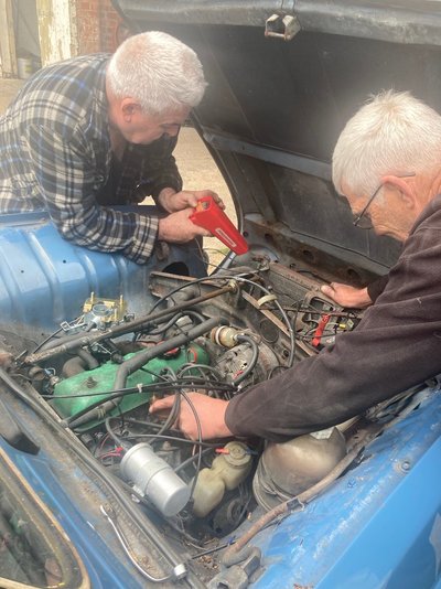

JUNE 2024
SAVED BY PAUL CUNNINGHAM!
I am reluctant to recommend him as we shall have to join a queue of others asking for his expert help.
solved the annoying problem in seconds....re: rubber hose air intake to carb.
Other issues identified for future visits.
Drove back from Worthing much happier - thankyou Paul ( all you Pauls have to stick together!)
ps. of course, re-reading Malcolm's comment, I now understand! You were absolutely correct. I think it is now
removed altogether. I will now find my Haynes manual....somewhere in a box.
