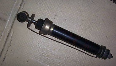

Has anyone found an affordable source of gas pressurised dampers in the UK (preferably deCarbon)? Ian mentioned he'd had a quote of approx £350 for a set of 4 from the only person that seems to advertise on the web. Which seemed a bit much. I know Renault don't sell them anymore - they sell Sachs-Boge dampers which fall apart in 5 minutes.

Gas pressurised all round are the best. Those dampers that are supplied with a strap around them otherwise they'd expand. They are essential for the rear, but for the front your ordinary dampers could be fine.

Typically shock absorbers do not affect ride height (even gas pressurised oned) but on the R4 (low spring rates) you may find that the height alters (especially if you fit gas/oil shocks in place of oil ones). The funny thing is that it would get lower on the rear!
