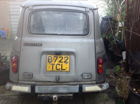

hi i ve just got one that's not run for 12years any advice about where to start please where do I get colours and parts please

Hey and welcome :) Nice to see another R4 come out of the woodwork to join whats left of the uk fleet.
There is a thread on one of the move active pages on colours so thats worth a nosey first but i'm sure the more knowledgeable guys on here know.
Parts, some still can be had by walking to Renault dealerships or car shops. 'some' thou but there are other places, like the internet.
http://www.franzose.de/en/Renault/R4/ - this site is the main go to place, bought a few body panels for my Gunmetal grey GTL from here
http://www.melun-retro-passion.com/pieces-occasion/renault/re_04-4l/idcat-RE.04.7.2.CAP. althought I haven't used this site, it came up in a search and thought i should save it.
http://www.r-quatre.nl/index.php is the lastest one, ordering parts from here is on my To do list as Franzose is out of stock on some parts I need :(
As for what to do about the car, give it a wash? check the engine turns over manually before doing anything to the engine, then go for new points, spark plugs, oil + filter and fresh fuel. My GTL withstood 4 years of doing nothing but my TL is needing a little more of elbow grease to wake up again
