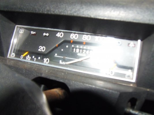

My Dad did up a 1981 Renault4 GTL in France, which we brought to the UK and we would like to get it registered before selling. I believe we need a new speedometer and to get lights adjusted. Any info welcomed and parts for sale. Excuse the poor photo.

Hi Clare, a few weeks ago someone posted a similar query and I'm sure that it was said that you don't have to change the speedometer. The lights definitely have to be adjusted though
The car was rejected for MOT without the correct speedometer. I am confused! I would be grateful to know what to do next.
It's annoying the car was rejected as the speedometer calibration is not an MOT requirement (it is a construction and use requirement but not one checked by the MOT). I have been running around in a R4 with km/h speedometer for years and nobody seems to mind.
The easiest fix is to get some little number stickers in mph and stick them to the front of the speedo. The only other difference apart from the markings is the odometer, and there is no rule I am aware of that requires it to be in mph.
It is definitely not a legitimate reason to fail an mot. (The only relevance of a km speedo in an mot is that the Vosa computer system gives the mot tester the option of entering whether the odometer reads in miles or kilometers). Ask the tester to show you where in the tester's manual it shows it as a "reason for refusal". (You can see the tester's manual for yourself online: I'll see if I can find the url and post it here later)
I'm a tester and the speedometer will only fail the M.O.T. if it (quote) "is not fitted, is incomplete, is inoperative, has a dial glass broken or missing or cannot be illuminated"; nothing about the units of measure used. Personally I ignore the rule about illumination-with the sunshine on a warm afternoon I have difficulty in seeing numberplate lights, leave alone the dashboard lights!

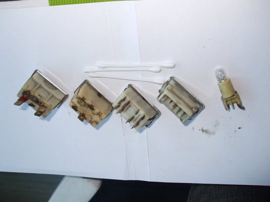

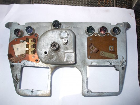

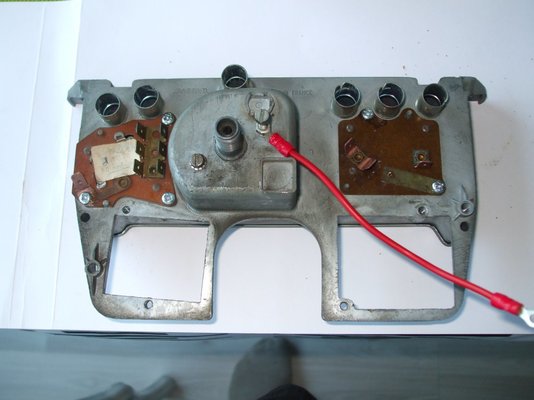

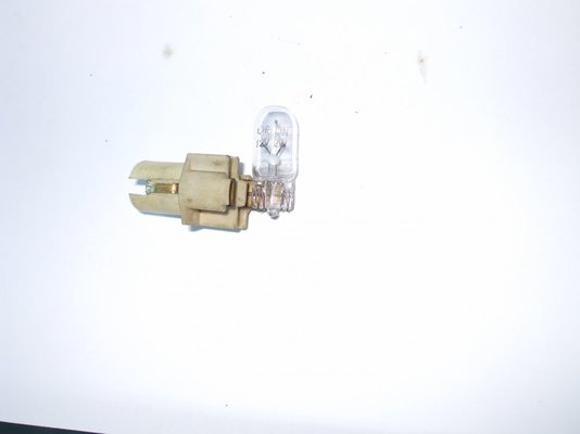

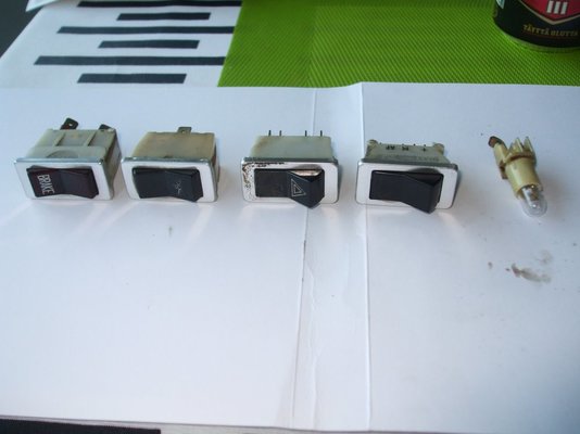

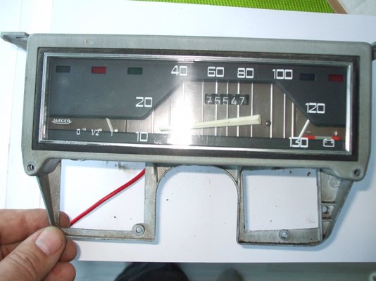

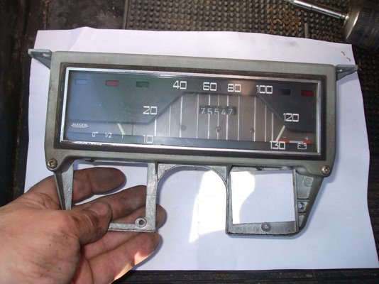

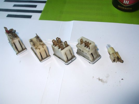

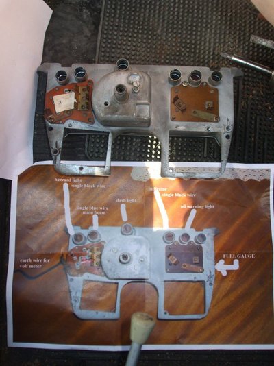

Took last week off the the instrument panel and it looked like this, inside just like new. After few hours work it looked like little better with pointer fond and put(glued) to its place. I'm checking all connections and seeking cause for odd earthing problems as well as partly or not lighted up bulbs.By the way, from where you could buy these kind of bulps with 12V and 2w only?

Question: earthing of the instrument panel, is it on the backside middle of speedo a elleiptic hole where a same form nipple with thread shall be connected?
- mine was loose when i took panel off, maybe took off when panel was disconnected or is the original cause for non lighting oil etc bulb for a long period?
