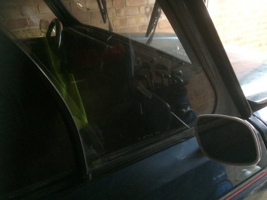

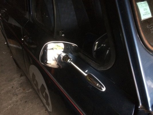

I fitted them and I cant see behind when I look across at the passenger side wing mirror.
Anyone had the same problem? Solution?

This is a common problem when fitting a driver's side mirror on the passenger side on any R4. The only ones that were factory fitted were on the F4/F6 and they had a longer arm for this very reason: to position the mirror at the correct angle for viewing from driver's seat. Maybe you can make it work by drilling the mounting holes at a different position, having an assistant hold the mirror on the door to deermine the best place. That said, I have never made a passenger mirror work for me, so I fit them just for aesthetics, or for parking help.
Another issue on such reproduction mirrors is that the mirror glass is of very poor quality, giving a very limited view scope and distorted images.
The original mirrors were made by Cipa and were of good quality. Later 'after-market' ones of lower quality were sold, still made Cipa. Over the last decade some very low quality copies of Cipa mirrors have become commonly sold by many of the parts specialists, (sometimes describing them as 'original'!).

Mine are the same Franzose mirrors. They are cheap reproductions and rust spots appear very quickly, but oddly doesn't get much worse over the next 10 years. With flat glass the mirror is too far away to be useful anyway. I couldn't get the glass out of mine as the white plastic seal is very stiff.

Thanks chaps I thought i was going a nbit mad but it seems i have fitted correctly.
