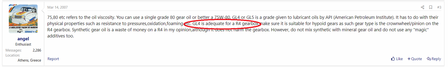

Gear oil?

GL4! @angel said several times...
GL5 is what you need and that is what @angel and @reidalpine wrote several times...
@JdeW , I used the wrong one in my first R4.
"The oil to be used must be of the API GL4 standard (SAE 80 or SAE 75) and oils displaying the API GL5 and API GL4+ standard should be avoided because they may contain sulfur additives which attack the bronze of the rings and crowns. This standard is displayed in small on the cans and it is sometimes necessary to look carefully. The recommended viscosity of the oil is 80W90, but failing that, 75W80 oil can be used because API GL4 oils are increasingly difficult to find."
