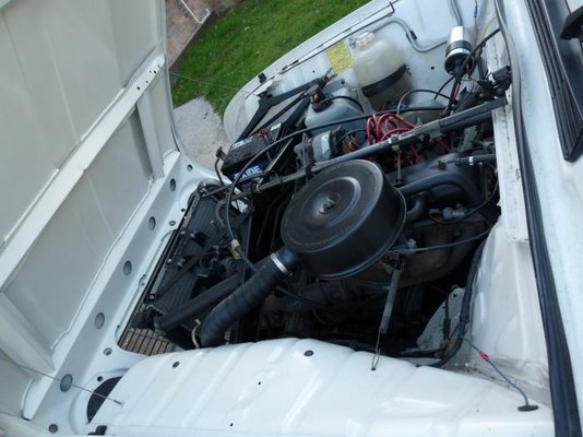

Sorry to ask a string of dumb questions - you can see I'm new to R4's - but I cant seem to get my air filter off. It's an 86 1.1 gtl. The wing nut comes off no probs, but either twisting firmly or pulling, I cant get the box off the carb, let alone access the filter element.
I dont want to pull too hard in case I damage something. There's not a hidden screw is there?

It isn't one of those funny one piece all in one air filters left?
Its a metal thing, much deeper than that plastic all in one on e-bay. I assumed it would split open allowing me to drop in the air filter. Ive tried to attach a pic.
Still cant get it off - useless ol me!

Grab the pipe that goes in in the air filter. Try to spin the whole cover a bit to one or another side.
That worked for me.
It just needs some more muscle!
As Godlike says, take the outer air hose off and then use the stub of the pipe to give you extra leverage, they do come to pieces!
