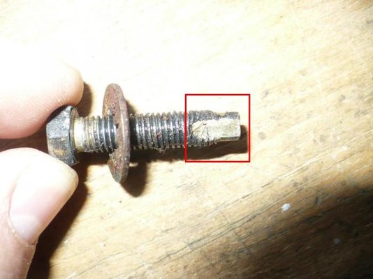

Can anybody tell ma why this bolt has this kind of top/peak (rounded?)
The rounded edge of the bolt was there, so that the thread does not get clogged with the body-to-chassis sealant during assembly in the production line. You can't find such bolts, however normal M7 bolts will do, provided you clean the threads with a tap (may be already clean) and you pass the bead of sealant around the threaded holes.
To fit M8 bolts you have to weld nuts from the inside (there is not enough material to open out existing M7 threads to M8), and this would be awkward or impossible on most of them. It's not necessary, either, M7 bolts are up to the job.
It's not necessary to go to stainless bolts, nor 10.9 grade. 8.8 zinc plated ones should be fine, and you can put some anti-seize compound on the threads prior to fitting them, just as a precaution.
When I did the same job on my white '75, I had all bolts, nuts, washers etc cadmium plated (that goldish finish the original bits had), and therefore was able to use all the original ones.
If you still have trouble with the bolts, I can easily find M7 stuff here (even zinc plated) and send them to you. Yesterday I even bought some M7 1m threaded rods, which I always thought that was non-existant. Good searching pays off!
